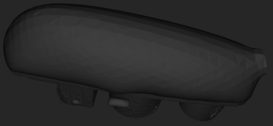

Here is my scan of the cupholder assembly from the QX80.
It's comprised of...many scans but they're happily aligned and have captured the information I need. When I select the Merge button, the render is as expected.
However the merged file is, I think, useless.

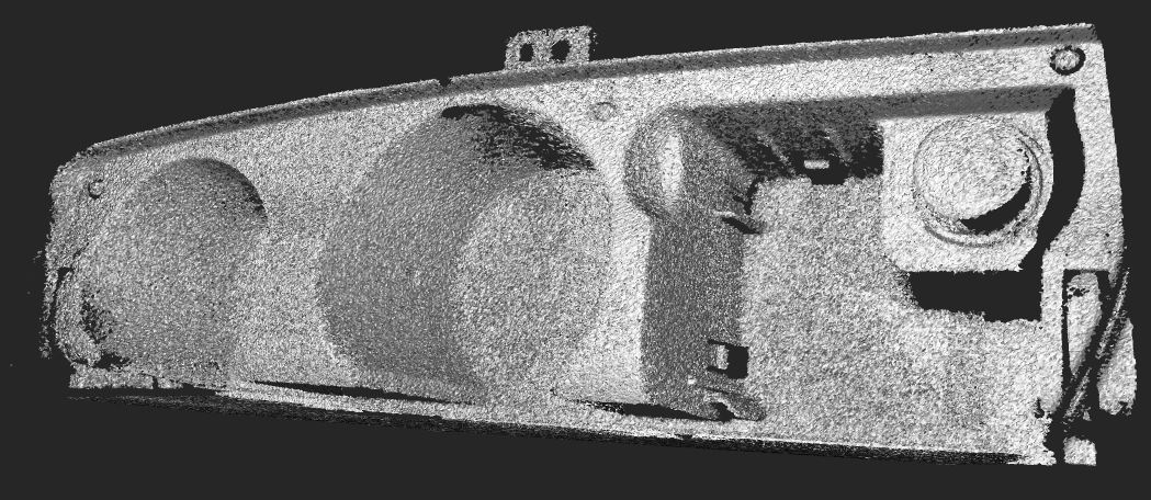

If I zoom in enough, the "interior" is just like the 2nd image, but how on earth do I make this a usable file?
