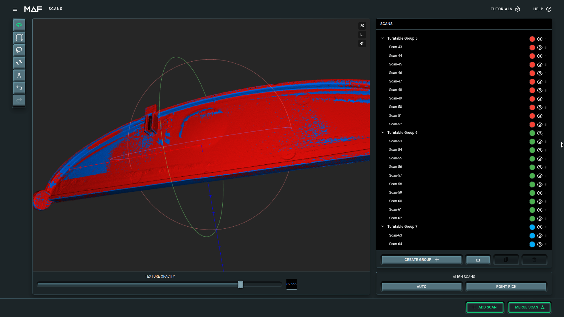

  • When scanning a toilet part, I did three scans. Red and Blue are the top, Green is the bottom (you could argue the Blue is redundant).
    Note how there is a black gap in the center which causes problems when creating the mesh.
    All scans visible

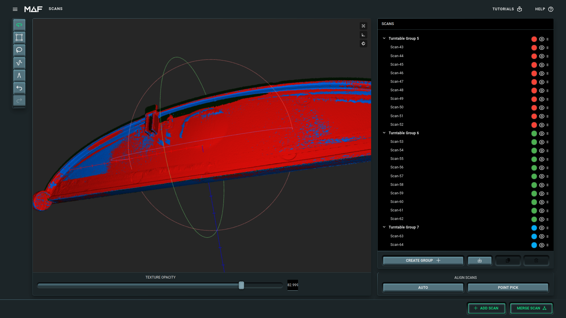

    However, when I now hide the Green (turntable group 6), it suddenly looks much better ?!
    I am quite surprised by this and I don't know how to solve it. Note that I need this group for the bottom part..

  • @Christian Gassner I always scan without texture support.
    I feel it is alignment related.
  • Hi Paul,
    That can happen when one scan, in this case your green one, is not well-aligned with the other scans. Keeping that scan will degrade the overall quality and removing it will improve it.
    You can try realigning the green scan to one of the others using point pick to get it more precise, or, if you're happy with the result without the green scan, just delete it.
