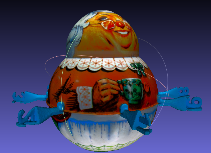

    Mrs Claus - Final Scan
    In the above image, you can barely see the repeated brighter pattern in the upper half of the Roly Poly.
    The idea of adding the magnetic references was only 'mostly' successful.  The reference letters turned out to be too small and the wrong angle for complete success.  It worked for aligning the bulk of the scans.  But, the individual top and bottom scans required picking material features as well since the numbers did not get captured clearly enough for point picking.
    Overall, I am very happy with the result.  In future tests, I will try to obtain better light balance between the top and bottom halfs of the Roly-Poly.  But, I was able to capture circumference, top and bottom with excellent registration and once completely cleaned of the reference objects, a person in the future would be able to get an excellent idea of the details of this fun but vanishing art form.  And, that is a great purpose for a 3D scanner.

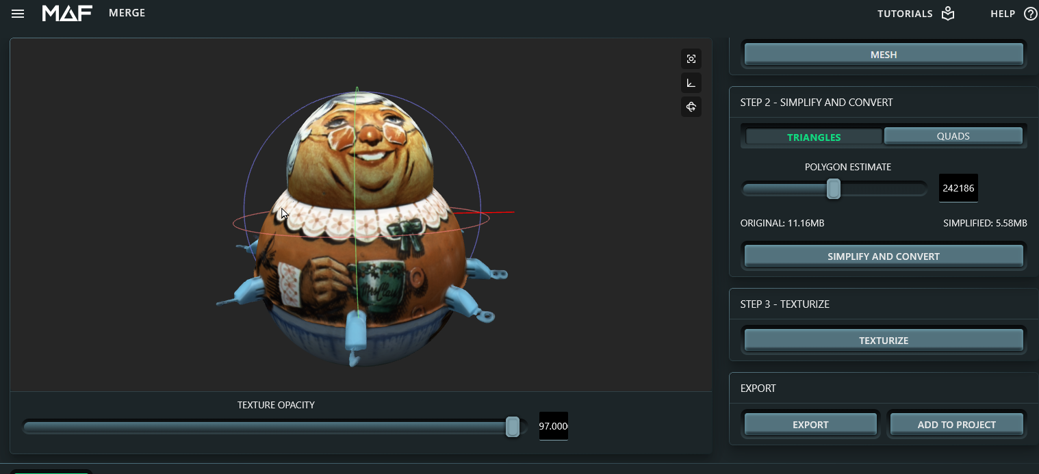

  • Here is a rough texture that was created by scanning the Roly-Poly upside down to capture the bottom at about the same light level as the top.  Two scan sequences and two individual scans were used for this result.
    Scan Sequence #1:  Bottom Up, 14 Steps, 360 Rotation (Top features removed from Capture Group)
    Scan Sequence #2:  Top Up, 14 Steps, 360 Rotation (Bottom features removed from Capture Group)
    Single Scan: Very Top of Head
    Single Scan: Bottom Base
    Composite Scans
