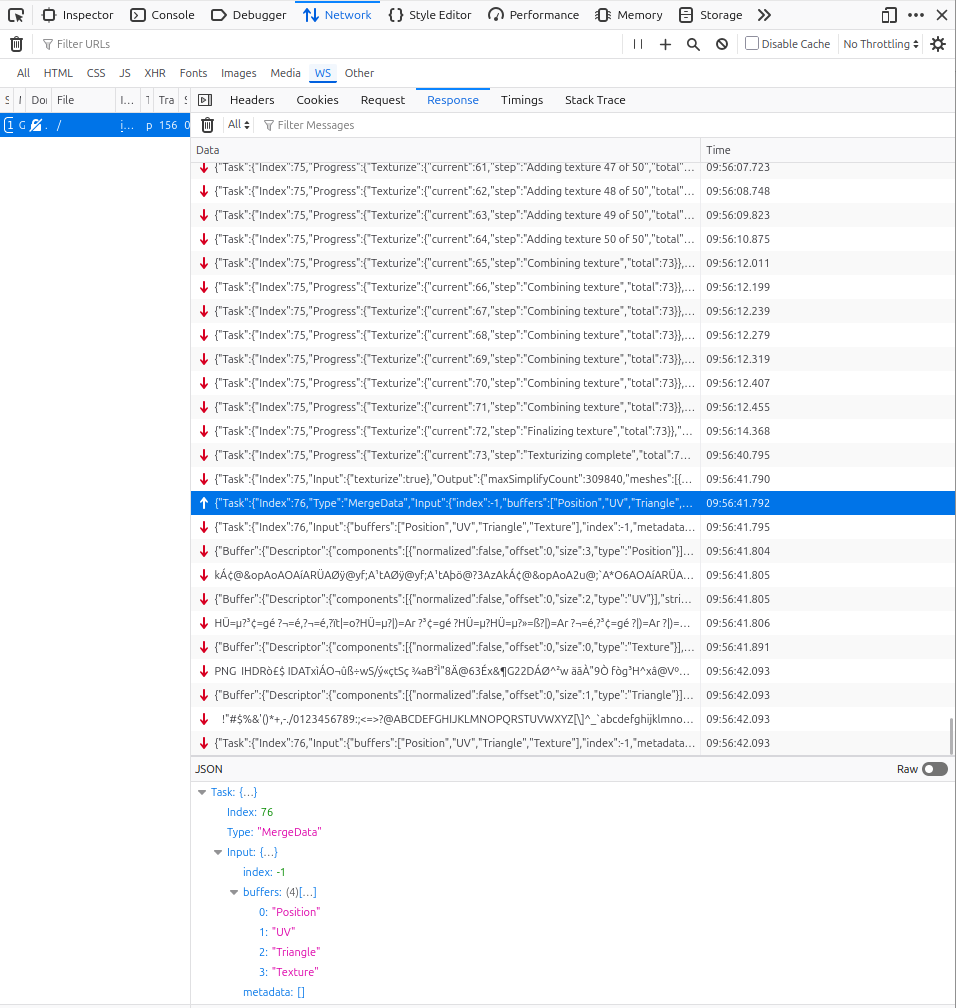

Inspecting
The last most important resource for anyone when trying to debug is to simply inspect what the front end is doing. Using any of the developer tools in your browser, you can inspect the Websocket communications, resposes and requests. This is also a ground truth for any communication, because of version differences, and old documentation. You can find an example of how to do this on Firefox here.
