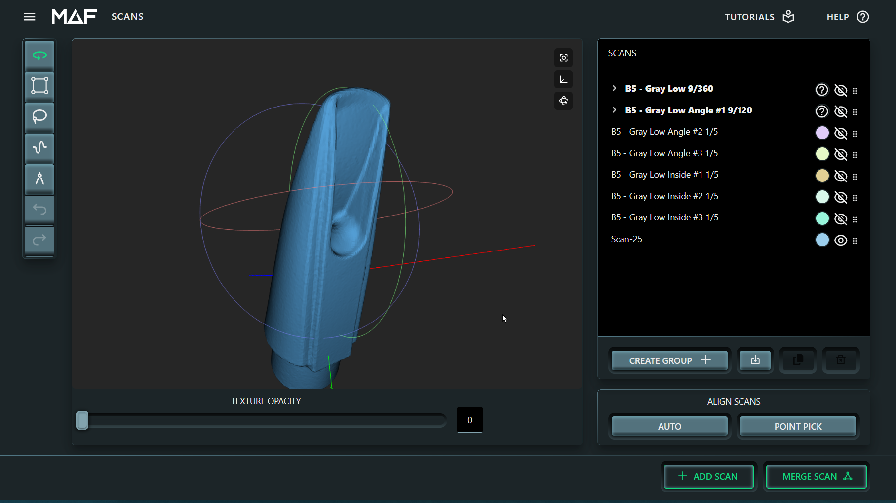

    Using a mount (see previous post) that allow me to rotate and orient both reference shapes and mouthpiece, I got the following results using Low Scan.
    Low Res Mouthpiece
    It is exactly what I needed.I first tried scanning spray; but, was not pleased with the brand I used.  So I painted the part with flat gray and that worked beautifully.  While I know that I cannot go too deeply into the base, I will continue to see how I might go just a bit deeper into the bottom of the chamber.  But, even if that is not possible, what I have now is invaluable in determing the differences in chamber shape between various mouthpieces.
