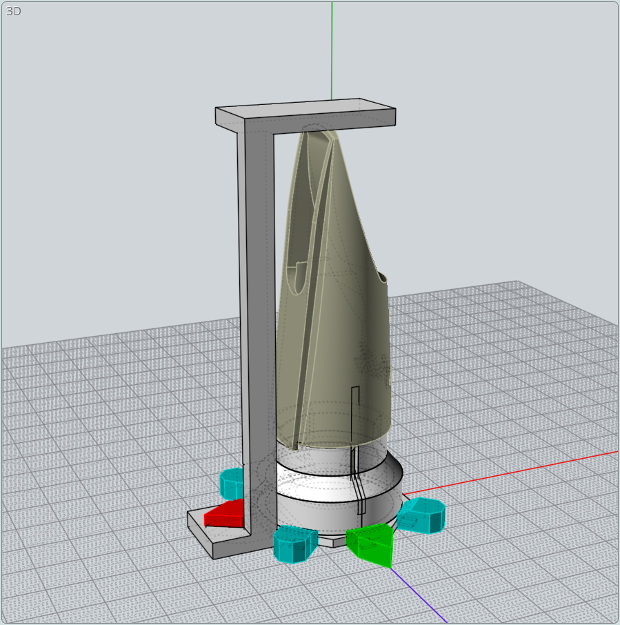

    Addressing the problem of the Scanning the Bottom of the Object
    The above stand and reference objects hid the bottom of the mouthpiece, preventing scanning.  While capturing the bottom is not absolutely necessary, my goal is to learn how to address scanning challenges.  In keeping with my assumption that the reference objects need to remain EXACTLY where they are relative to the object for aligning the bottom scan with the previous scans, I came up with this solution to try.
    Botom Scan Solution
    What will be important is to make sure the slipover scanning refwrence table is EXACTLY aligned, both in rotation and distance from the bottom.  I'll be trying this new table this weekend.  Hopefully, it will do the trick.

    The Saddle slide-in support with the feature allowing capture of the bottom
    Bottom Scan
  • One of the things I ran into was a tendancy to rotation the object directly, rather than rotate using the reference object.  This inadvertantly caused the mouthpiece to slip off-center.  While it could be aligned by sight, there was no way to ensure that putting it back was going to absolutely align with earlier scans.
    The solution was to create an alignment and height tool that would ensure the reference object was in perfect alignment with the flat platform of the mouthpiece and also ALWAYS put back on the exact height.  This had the added benefit of giving me the exact distance and design for the bottom alignment tool which slipped over the bottom of the mouthpiece.
    Alignment and Height Guage
