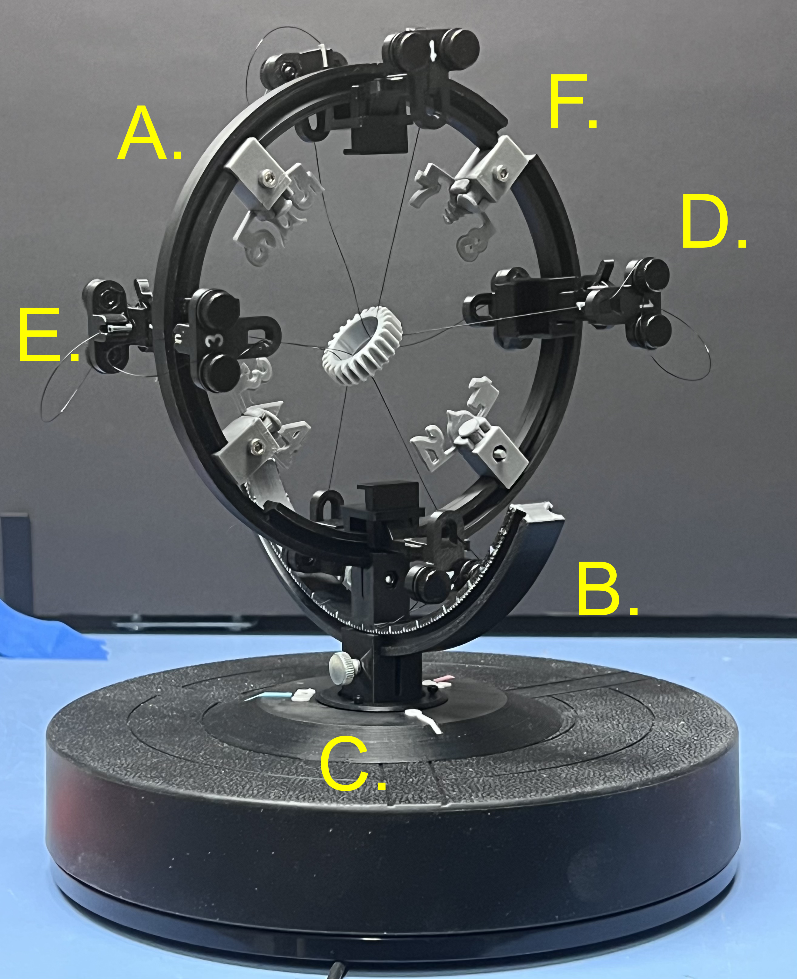

Pursuit of this quest should result in multiple scan 3D staging designs. Most require some significan hardware, like screws and nuts. But, one of the goals I wanted to achieve was to design something that was almost completely 3D printed. The result was this design that still requires two 3mm bolts with nuts.
This Ring Ring relies on very thin >.25mm clear monofilament sewing thread to position the target ring near the center of the rotating ring. I will upload the files if it is successful in reaching our goal. (I ran out of time this weekend to try it.)
The monofilament is streteched between adjustable outrigger hangers by being wound around hubs and held in place with a locking cover. The question will be just how to run the monofilament to hold the target ring in place tightly with the least interference with scanning the featueres. Considering the possible combinations tests critical thinking skills to the max.
Here is The Ring RING:
Note: The crossbeams can be secured in place with 3mm screws or the small 3D printed sliding locks in the lower right of the image.
