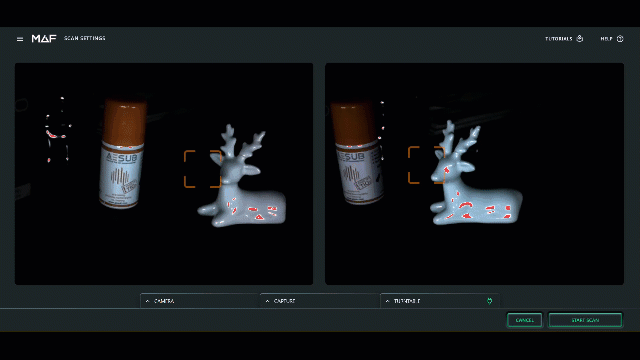

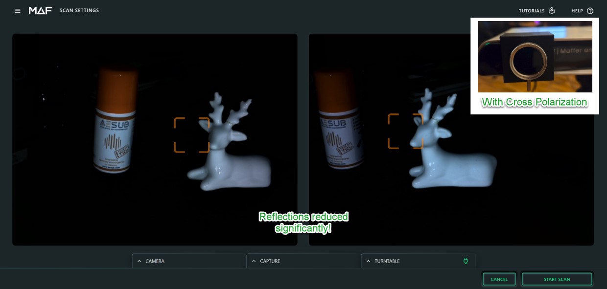

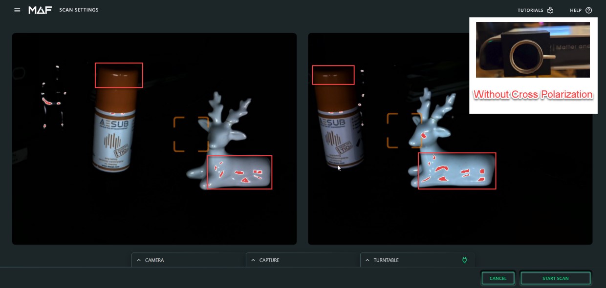

    MAF3 and external lights equiped with polarization filter. Polarization from ligths and cameras are crossed by 90° to reduce light reflection a lot.
    Without cross polarization lot of reflections visible!
    With cross polarization used, the reflections are reduced a lot ... almost completely eliminated!
    GIF animation is showing the difference when changing the polarization filter on the MAF3 cameras from non-crossed to crossed position.

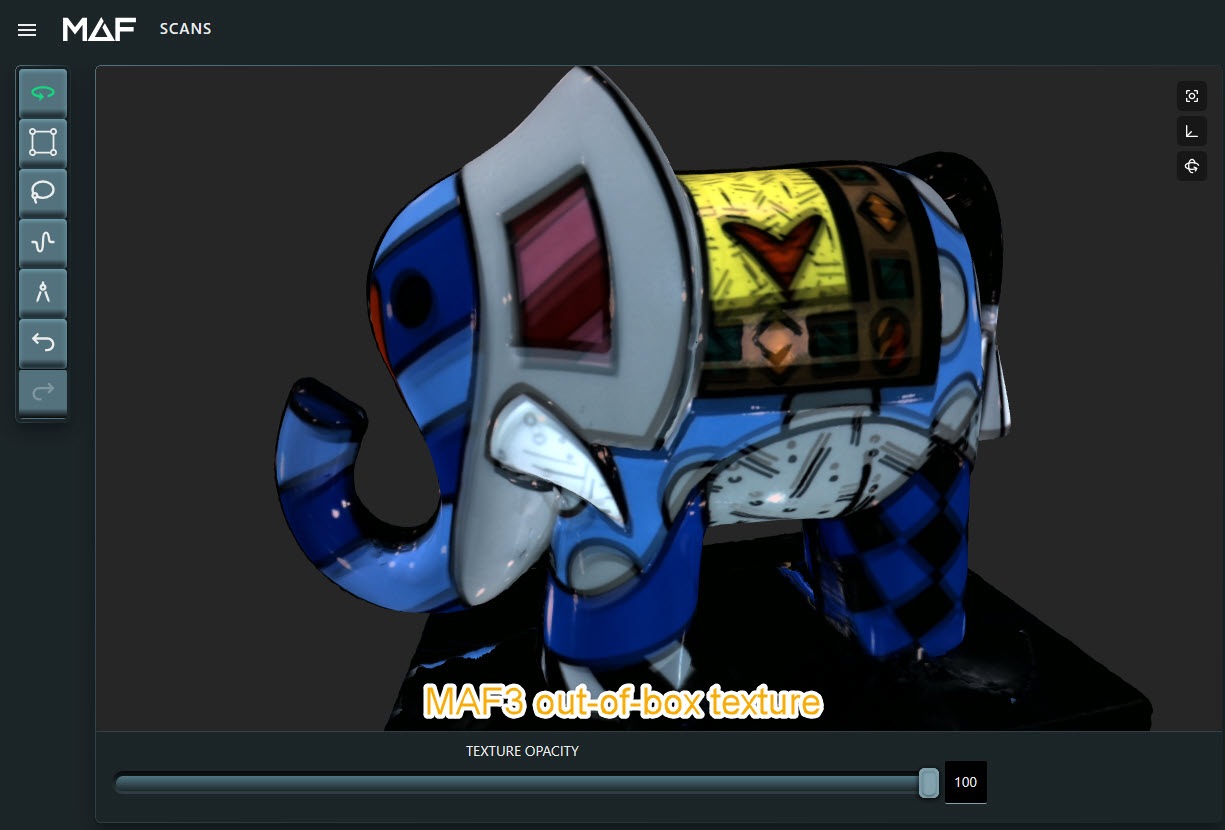

    Texture quality out-of-the-box, without external lights, without HDR, without CP. Dark areas are under-exposed without lot of details. Increasing the exposure settings would lead to exceeding the saturation for white area because of low dynamic range of cameras.
    MAF3 out-of-box texture quality

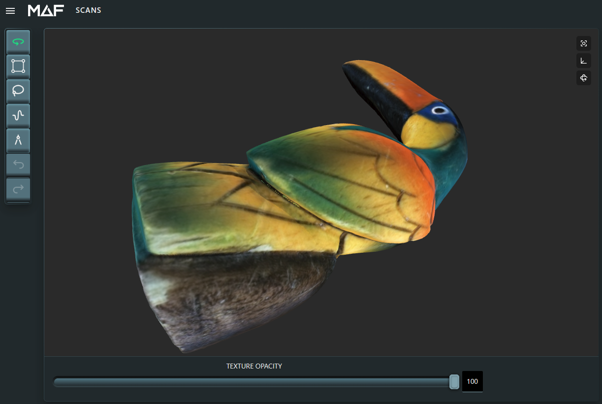

    Improved texture quality with external HDR processing (3x images, normal/over/under-exposed), without external lights, without CP. All images captured with in-build MAF3 cameras. The texture quality is much better and the color range is increasing a lot. Also dark areas are showing lot of details. Drawback still are the reflections (white spots) because of quite shiny surface.
    MAF3 with HDR texturing (no external lights)
    Further improved texture quality with external HDR processing + external lights + cross polarization. Polarization filters added on MAF3 cameras and crossed by 90° to external LED lights. The texture quality is almost perfect. Light and dark areas are showing lot of details and reflections have been almost eliminated by use of cross polarization method.
    MAF3 using HDR + external Lights + Cross Polarization

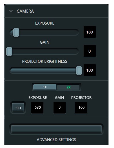

  • At what stage do you currently capture the three images?  Do you simply repeat the same scan three times at different brightness values?
    I assume adding HDR to the THREE would require a setting where 3 images are captured for each scan?
  • Correct! Currently i am repeating the same scan several times as you mentioned.
    1. First turntable scan with e.g. 8 scans + texture.
    Exposure, Gain, Projector optimized for mesh scanning.
    But also texture is captured, which will be later replaced with offline created HDR image.
    (Optional: If object has light and dark areas it might be needed to perform another turntable scan with higher exposure, gain and projector settings to also capture mesh from dark areas. This time the texture should be disabled. Later this second scan need to be aligned with first round and moved to the first project folder. Unfortunately MAF3 does not have HDR for point cloud capturing as many other structured light scanner have. So this workaround could be used.)
    2. Second turntable scan without moving the object. First HDR image (normal exposure).
    Exposure, Gain optimized for white/light area (no red indication indicating overexposure).
    Projector set to zero, external light switched on.
    3. Third turntable scan without moving the object. Second HDR image (overexposed).
    Exposure, Gain optimized for black/dark area. Light areas are extremely overexposed.
    4. Fourth turntable scan without moving the object. Third HDR image (middle between normal/overexposed).
    Exposure, Gain set to the middle of the values normal/overexposed.
    Same procedure to be repeated for another set of capture poses. E.g. Top/Bottom or Top/Left/Right

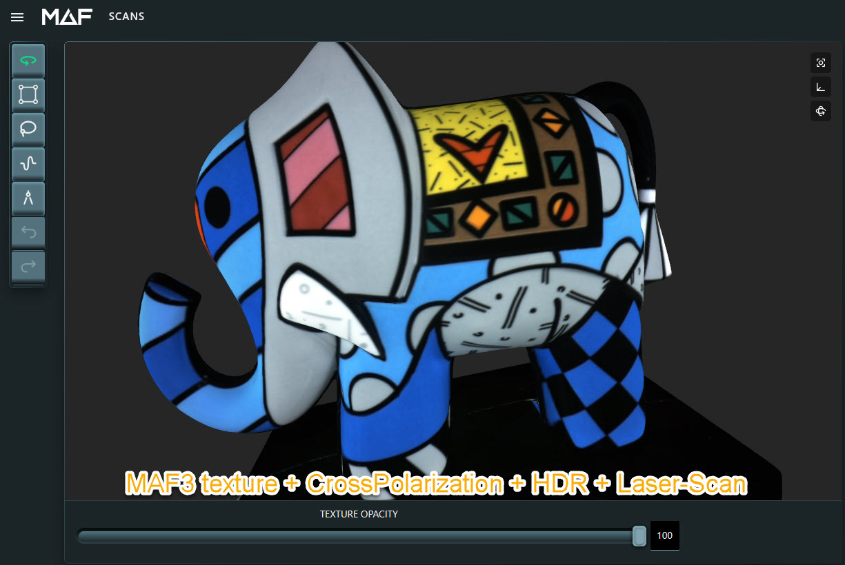

  • Another comparison of out-of-box result VS using CrossPolarisation + HDR + imported STL from laser scanner. Importing external mesh is to get best mesh quality because structured light scanner cannot scan shiny and black areas very well. It's optional but good to have this possiblity in MAF3 software.
    The 3x HDR images are not perfect because some shift caused by inaccurate repeatability of turntable movements. Also some minor reflections caused by the projector which was needed to be removed in photoshop with minimal effort because the 3x HDR images must be captured with projector light to avoid "cannot triangulate points" error. I could not capture only texture images without need capturing also point cloud which does not allow to block projector light completely. Because of this issues mentioned it is mandatory to get SW support using this method using CP and HDR.
    @MAF dev team: Are you willing now to support HDR method for texture capturing? Also makro based solution which can be customized by user appreciated.
    MAF3 out-of-box texture:
    MAF3 improved texture using CrossPolarization + HDR + imported mesh from laser scanner:
    Setup using external ligths with cross polarizaiton filters on LED lights and MAF3 cameras:
    Using this method would allow MAF3 to become unique 3d scanner with outstanding texture quality. With handheld scanner this is almost not possible to use this method. Comments welcome!

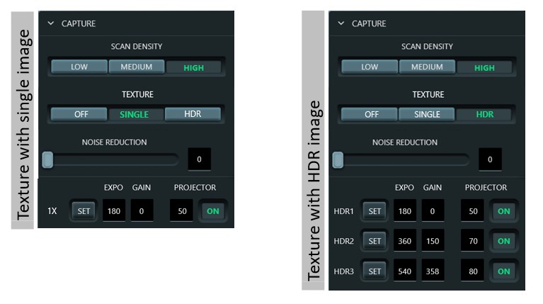

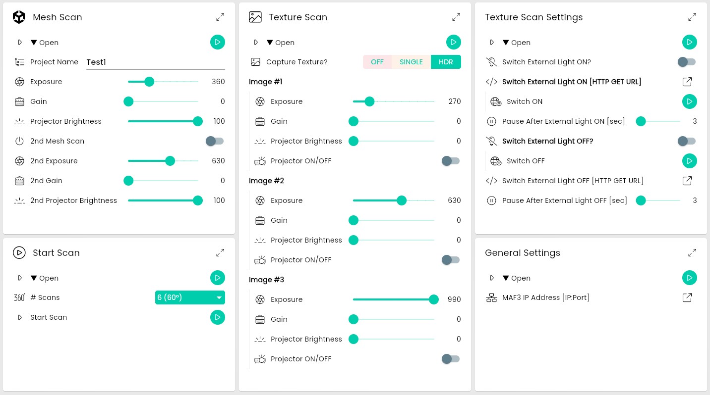

    @Drew Shark Here my proposal for the implementation of HDR and external ligth switching. Beside this i think it would be also good to have option for 2nd point cloud scan with different exposure settings. This would be "HDR Lite" solution for the point cloud scanning. For point cloud scan just the points from both scans should be merged into one. It's simple but very effective and also other structured light scanner on the market are doing it like this. Both improvements for point cloud scanning and HDR for texture will boost the performance from the MAF3 a lot! Based on the testing i have done manually it can deliver outstanding results. Almost not possible with handheld laser scanner. ;-)
    PROPOSAL FOR 2nd SCAN OPTION TO CAPTURE POINT CLOUD (HDR Lite)
    TESTING:
    GUI IMPLEMENTATION PROPOSAL:
    PROPOSAL FOR HDR TEXTURE
    GENERAL SETTINGS & PROCEDURE (for external light switching with http get command)
    I know that this will be quite a lot of work to implement but it will allow to fully exploit the potential of the MAF3. Everything which is requested here is "doable". This is just a first proposal and other implementation might be more useful.
    Looking forward to your comments and questions regarding this proposal.

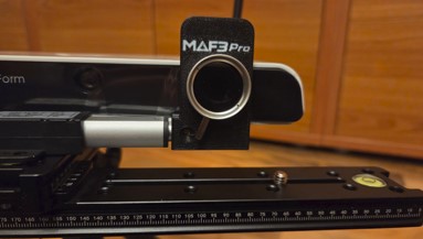

  • @Tom Meeks The filter holders are 3d printed. I will upload them to Makerworld tomorrow. For the time beeing it's very simple design for testing, but it works. I have made two options.
    One with 25.5mm circular polarization filter made from glass (Model: Hama, Silver Edition, 25.5mm).
    Another version with linear polarization foil, the same i am using for the lights but rotated by 90° (Model: Screen-Tech, ST-38-20, linear polarisator).
    The filter i have designed for the LED lights which i am using you can download here:
    https://makerworld.com/de/models/1499365-polarizing-filter-for-smallrig-rm120-led-light#profileId-1568309
    But for first testing you can also cut the foil and use some tape. ;-)
    By  using the glass version you might loose less light, but also with foil on cameras you can achieve excellent results. Using cross polarization makes only sense for texture. For scanning you would need to apply also filter on the projector and you will loose to much light which makes scanning extremely difficult.
    And for texture you only need to have filter for one camera because maf3 uses only image from left camera for texture. I would love to change it to right camera because it has more distance to the projector which would make it easier to use ringlight for texture.
    I am already working on next further improved version which will only use one filter for the left/texture camera. I will motorize this which allows me to remove the filter for scanning. For texture i want to switch on the lights and move the filter in front of the camera. More to come ...
